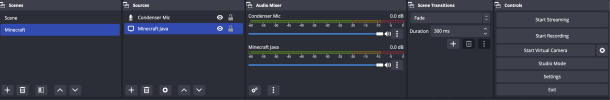

Hello, I am trying to play and record Minecraft Java on my MacBook Pro M2 Max. However, I am having some serious issues with the settings I have chosen. My recordings end up looking like a slideshow. My MacBook is pretty beefy in it specs, so I did not think it would have very many issues. Should it be able to support the chosen recording settings or higher shown in the Output>Recording image? I want 60fps while not losing many frames. I also do not want a grainy video as the alternative. What are the best settings while gaming and recording in Minecraft on Apple Silicon that does not sacrifice quality?
Thank you for your answers!
**Update: This is also happening is Apple ProRes Hardware.
**Update: Turning off game mode on Minecraft Java and using Apple ProRes Hardware encoder created a quality video that was really smooth. However x264 encoder on 60000 bit rate was still incredibly choppy. Apple ProRes is fine for me, but my question is, is it normal for my Mac to have such issues with x264 at 60000?
