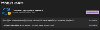

Greetings! obs does not work for me at all after updating Windows.
…tried to reinstall - nothing. deleted all plugins - nothing. deleted obs and all files - nothing works again.
I start a clean obs, try to add my capture card and it crashes…wtf?)
@whoisMAKS make your own thread because you may have different issue. Describe step by step what you doing (how to reproduce the issue) and attach your log from the same session where problem present.
I fix it backup windows update.
Win 11 update kill OBS
