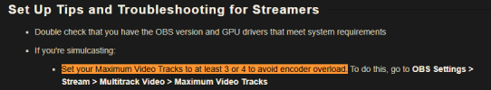

Now that you mention it, I have not been manually stopping the YouTube output in Aitum Multistream. I've simply been pressing the "Stop Streaming" button on OBS to cut my main stream output to Twitch.
I'll have to try and stop YouTube's stream manually and see if that fixes the crashing issue.
Thank you so much for your time. I'll reach back out if the issue persists after trying this potential fix.

Ok, you mentioning Enhanced Broadcasting I think helps a bit. I did set something to 4 when setting up Enhanced Broadcasting, but the setting was not named lookaheadDepth, or anything remotely similar. The setting I changed was called "Maximum Video Tracks" under File>Settings>Stream>Multitrack Video.
The official Twitch page explaining how to set up Enhanced Broadcasting suggests setting this to 3 or 4 if one is multistreaming to avoid overload.
This is the only thing I changed. If this is not what you're talking about, I'm completely lost.
Thanks anyway.
