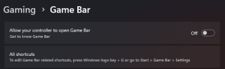

i will start a little stream on the gaming pc just to post its logs here, other than that i will try to disable the stuff at the top and go again 12+ hours stream on streaming pc to see if the audio lags behind. It just sucks that this takes hours of streaming to see if the problem still happens.(just checked too game dvr and game bar are turned off on gaming pc but obs says its still on?)
Disable that stuff before testing so you're not wasting more time than necessary.
Also, test the PC's separately, need to isolate the issue & determine where the lag is originating from.
