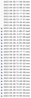

Thank you for your help. I'm still not able to do it, I've tried several different outputs but nothing seems to work.. From Matroska to mov or mp4, with dashes or without them, I've tried many different combinations but I can't get my files to work with QT or Finder.. By checking the log file, I could detect when the Video Encoder Settings failed or worked but sometimes even when it did not fail, it also did not apply the settings I was asking.. Like if it was not failing but it was ignoring my request.
If there is anything else you could think of to help me, it would be really appreciated. Thank you again. =)
