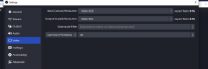

Think i found a bug. When you change the video base and output to 1080x1920, it crashed OBS. When you toggle the output on.

* Fixed crashes when using less-typical video sizes (ex. 9:16 portrait resolutions) in OBS.
Note that the droidcam virtual camera drivers are still limited to the standard 640x480...1920x1080 options. Output from OBS will be scaled to fit into whichever one of these is being used by external programs.
