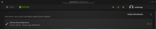

*ATTACHED OBS LOGS* Failed to initialize video. GPU not supported, graphics drivers need to be updated.
solarbugs
I have a NVDIA GeForce GTX 1650, running Direct X at 12. Whenever I have tried to open OBS it keeps showing me this error. I have updated my drivers, to no success, they are the most up to date they can be. I have tried uninstalling and reinstalling OBS, again no success. I have no idea what to do as nothing is helping anywhere and I don't know what else to do at this stage. Attached the most recent log.
